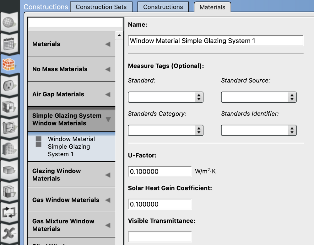

In order to create a glazing type (with specific aluminum framing, double glazing, coating, gas fill, etc.) with specific SHGC's, R-values from scratch, OpenStudio Application allows users to create some fenestration materials and constructions[1]. However, not every EnergyPlus option is available through the OS App.
The most basic is the Simple Glazing System Window Material (requires rated U, SHGC & VT) - look up the "Materials" sub-tab under the "Constructions" tab:
