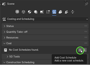

Cost Schedules can be added under the Blender Scene Properties > Cost and Scheduling > Cost Panel.
Clicking "+ Add Cost Schedule" will add as many schedules as required.
