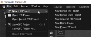

# You can find the command in Blender under File > New IFC Project > Choose which unit, template, or from the wizard panel
# Make sure to use IFC4 or IFC4x3, otherwise convert your IFC2x3 file to IFC4

  • Option 1: Native authoring of IFC in BlenderBIM
Quick Project Setup, Schema and Data directories
  1. You can find the command in Blender under File > New IFC Project > Choose which unit, template, or from the wizard panel
  2. Make sure to use IFC4 or IFC4x3, otherwise convert your IFC2x3 file to IFC4
