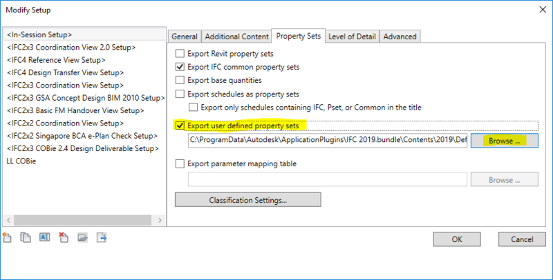

Setting up property set mappings
The Revit IFC exporter also requires the user to define property sets to be exported. By default, the definition is empty. A template is provided below.
A starting template for Revit user defined psets can be found here: .
The syntax of defining custom property sets is also explained in this video: https://www.youtube.com/watch?v=SswHKtcM3mI

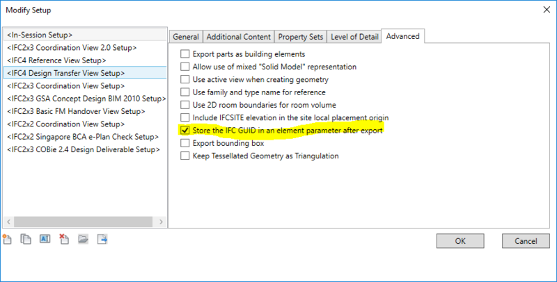

Revit and IFC GlobalId attributes
IFC GlobalId values do not exist in a default Revit project file. To create and see the GlobalId select the checkbox shown below select the Store the IFC GUID in an element parameter after export option in File > Export > IFC > Modify Setup > Advanced window, as shown below. It is highly recommended that this option is always enabled.
After your export is complete, you can now see a new parameter called IfcGUID for your objects as shown below. Despite the inconsistent naming, this is actually the IFC GlobalId. This property can now be overridden, copied, or searched for. If the text is deleted, it will be rewritten on your next export. Revit will always rewrite the original GlobalId, with whatever id is written inside Revit. There is no way to automatically regenerate a fresh ID for an existing Revit object, so if it is overwritten is can only be retrieved by finding it manually in the IFC file.
