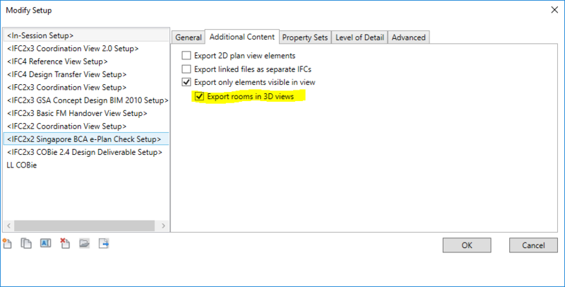

If you are exporting from a 3D view which has filters to turn certain objects on and off, you may have enabled the Export only elements visible in view option in File > Export > IFC > Modify Setup > Additional Content. If this is enabled, you must enable the Export rooms in 3D views option, or IfcSpace entities will not be created in your IFC file. Despite the use of the word “rooms”, the option applies to both Revit Room and Space objects.
