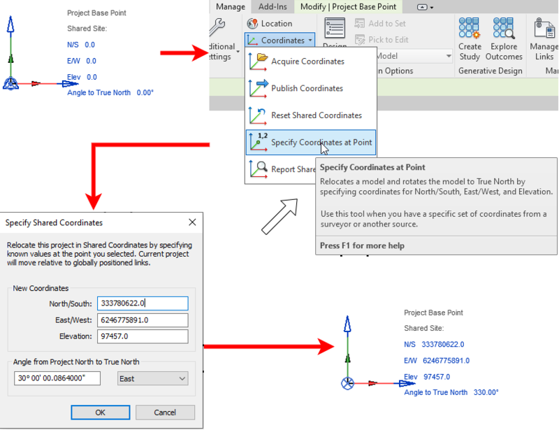

Set coordinates
Specify your Project Base Point coordinates according to data given by your surveyor :
Your Project Base Point should not move relatively to your building / elements. You might also want to apply coordinates to Survey Point to keep both at same location.
Alternatively, you can unclip Survey Point, set coordinates in properties, re-clip it then move it to your Project Base Point. You still need to set angle to north in Project Base Point.

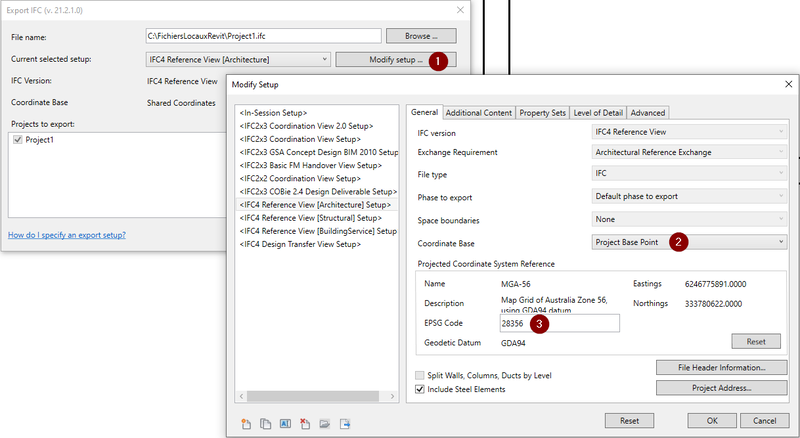

Specify global positioning information during export
  1. Modify your export setup
  2. Select Coordinate Base -> Project Base Point
  3. Input EPSG Code. It should be a valid EPSG number see EPSG website or ask your surveyor.
Result
You should see an IfcMapConversion in your ifc file after export under IfcProject.RepresentationContexts[0].HasCoordinateOperation[0] :

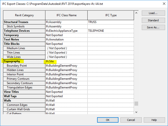

If your project is IFC2X3, you must create a Toposurface object. It must be set to export as an IfcSite object as shown below. When it is set, it will override the auto-generated IfcSite entity that the Revit exporter creates.
Warning: When a Toposurface object overrides the generated IfcSite object, it will also override any parameters you have set in the Project Information object related to the site. For example, if the Project Information contains a SiteName parameter and the Toposurface object contains an IfcName parameter, the IfcName will take priority. You will be required to transfer all your attributes to the Toposurface object.
This Toposurface must be assigned the instance properties as shown below.

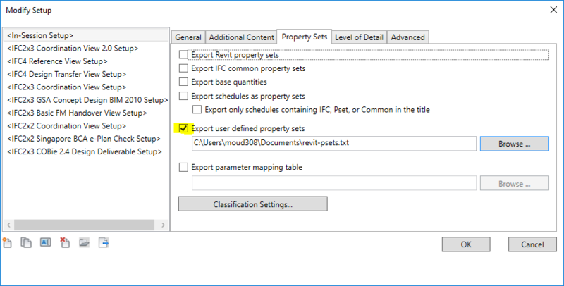

Once applying these properties in IFC2X3, you will be required to define property sets for export in the default IFC exporter. This is data filled in a text file, which is referenced in the IFC export settings as shown below.
The text file must contain the following listing.
PropertySet:	EPset_ProjectedCRS	I	IfcSite
	Name	Text	EPset_ProjectedCRS.Name
	Description	Text	EPset_ProjectedCRS.Description
	GeodeticDatum	Text	EPset_ProjectedCRS.GeodeticDatum
	VerticalDatum	Text	EPset_ProjectedCRS.VerticalDatum
	MapProjection	Text	EPset_ProjectedCRS.MapProjection
	MapZone	Text	EPset_ProjectedCRS.MapZone
	MapUnit	Text	EPset_ProjectedCRS.MapUnit
PropertySet:	EPset_MapConversion	I	IfcSite
	Eastings	Real	EPset_MapConversion.Eastings
	Northings	Real	EPset_MapConversion.Northings
	OrthogonalHeight	Real	EPset_MapConversion.OrthogonalHeight
	XAxisAbscissa	Real	EPset_MapConversion.XAxisAbscissa
	XAxisOrdinate	Real	EPset_MapConversion.XAxisOrdinate
	Scale	Real	EPset_MapConversion.Scale

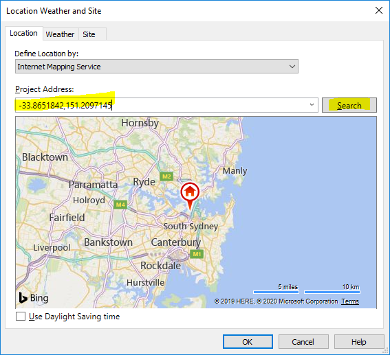

IFC also stores some “reference point” geolocation data. This data includes the latitude and longitude in WGS84. This data is a double up of the more detailed CRS-specific coordinates created above, and is therefore superseded. However, in Revit, it is often incorrectly set, so it is important to ensure that it is correctly defined and corresponds to the CRS-specific coordinates, to prevent unnecessary misunderstandings.
To store the RefLatitude and RefLongitude correctly in the IfcSite object, the CRS coordinates must be converted into WGS84, or EPSG:4326 coordinates. EPSG.io is one online service that provides this, but no guarantee of correctness is provided.
Once converted, they may be entered in the format {latitude},{longitude} in the Revit location dialog as shown below. Once entered, press the Search button to confirm the selection.
When the Search button is pressed, Revit will attempt to reverse geocode the coordinates. This is not guaranteed to result in a human address that corresponds to the legal address that represents the project entry. It is highly likely that you will be required to override this address. Simply replace the address, and ensure Revit doesn’t save over it, as shown below.
