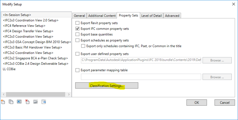

You will be required to modify classification settings. The classification settings dialog can be found in the File > Export > IFC > Modify Setup > Property Sets > Classification Settings … location.
The details of the classification system that you are using will be entered into the fields of this settings window. An example is shown.
These values will vary depending on which classification system you are using. A list of standard values are provided in the IFC classifications page. The value of Classification field name will vary depending on whether you use the plug-in or not to manage your classifications.
