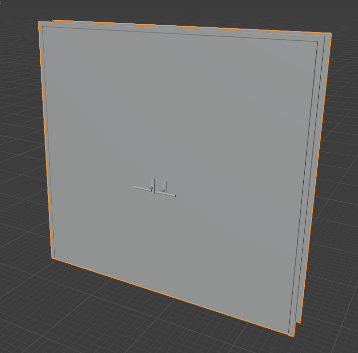

An innocent looking door
This is especially relevant to the architectural discipline. A common example can be seen in door and window frames, hardware, and furniture. For example, the following door object. The door contains a frame which is a profile swept along a path. The profile contains multiple fillets.

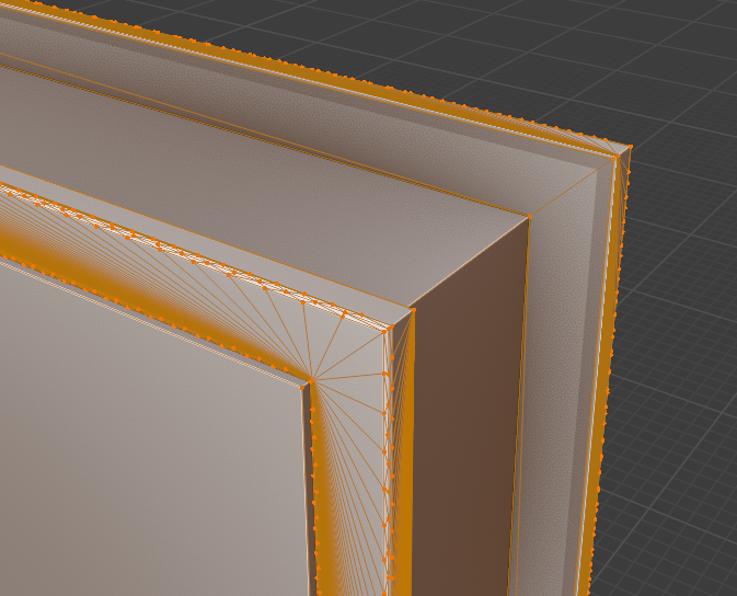

A door with over 8,000 vertices
Bonsai lets you inspect the details of how Revit generates shapes. In mesh edit mode, it is revealed that this door contains more than 8,000 vertices. Zooming into the door frame reveals the strange meshing artifacts that Revit has generated. You will notice that the artifacts do not occur in simple extrusions, such as in the door leaf.

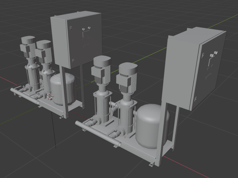

An object remodeled in Blender
In some scenarios, when it is not acceptable to reduce the geometric fidelity in Revit, it is necessary to switch to alternative software to generate IFCs, which either have improved mesh support, or improved ability to store parametric information in the IFC format.
In one example, a single object originally exported into a 16,098kB IFC file from Revit was remodeled in Blender, with a resulting IFC filesize when re-exported from Bonsai of 455kb.
