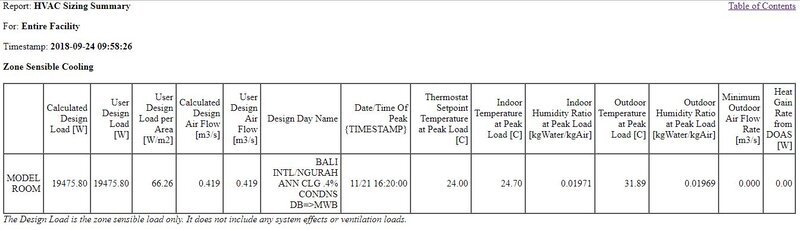

As you can see the sensible cooling load for the zone is 19.47 kW.

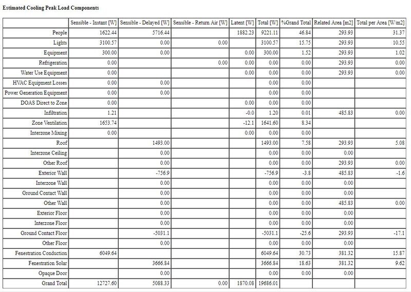

From the cooling load breadown, the total sensible cooling load is 17.8 kW and the latent cooling load is 1.87. The sensible cooling load is quire different with the HVAC Sizing Summary.
