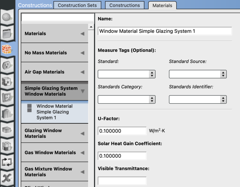

In order to create a glazing type (with specific aluminum framing, double glazing, coating, gas fill, etc.) with specific SHGC’s, R-values from scratch, OpenStudio Application allows users to create some fenestration materials and constructions1. However, not every EnergyPlus option is available through the OS App.
The most basic is the Simple Glazing System Window Material (requires rated U, SHGC & VT) - look up the “Materials” sub-tab under the “Constructions” tab:
