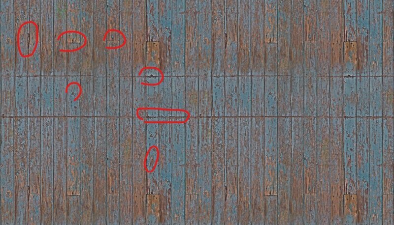

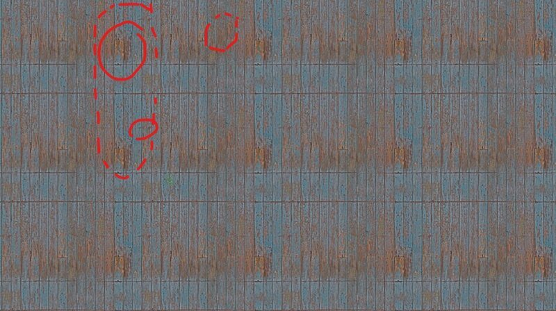

Removing Prominent Features and Details
We’ve removed seams and the color transitions are believable. However, zooming out, we can clearly see repetition patterns arising on the most prominent features:
If we zoom in a bit we can also see even more evident repetition, in this case of some details:
We should consider what to do with these as:
  • Imperfections matter for the quality of some materials. Without them the materials will be less interesting.
  • O bigger surfaces like bigger buildings, those features might cause a lot of harm to images as they make it easy to tell they are rendered. If you’re not seeking to make realistic renders you might ignore the following steps, otherwise, as the tiling they produce is obvious those can also be addressed.
For the sake of this tutorial, using the clone tool again, we will remove them:
