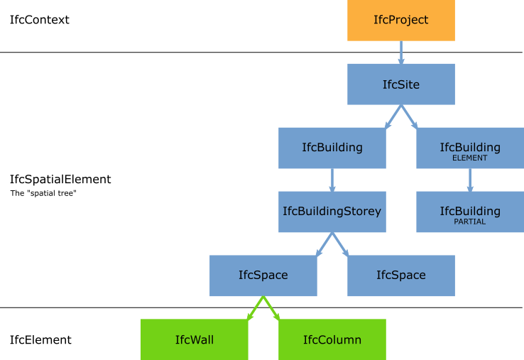

IFC spatial tree
An example spatial tree. Orange classes belong to IFC context, blue classes belong to <code>IfcSpatialElement</code>, and green classes belong to <code>IfcElement</code>. Blue arrows represent an *aggregation* relationship, and green arrows represent a *spatial containment* relationship.
IFC data often, but not always, contains what is known as a spatial tree or spatial hierarchy. This is a tree of classes that inherit from IfcSpatialElement that describe the spatial organisation of a building. For example, it might describe that a site contains two buildings, and each building contains 5 storeys, and each storey contains 3 spaces.
As all IFC data must start from an IFC context, such as an IfcProject, the top level of the spatial tree is assigned to the IFC context. If the context is an IfcProjectLibrary, a spatial tree may not exist. This top level of the spatial tree may be any IfcSpatialElement, but is commonly an IfcSite class. The relationship between the top level of the spatial tree and the IFC context is known as an aggregation relationship, or as spatial (de)composition.
Within the spatial tree itself, a IfcSpatialElement subclass may then contain zero or more IfcSpatialElement subclasses. This builds up a spatial hierarchy. For example, IfcSite may contain multiple IfcBuilding. This relationship between IfcSpatialElement subclasses is also known as an aggregation relationship, or as spatial (de)composition.
Usually at the bottom of the spatial hierarchy, the spatial tree may end and contain actual physical built elements, such as walls and columns. Walls and columns are not IfcSpatialElement, but instead belong to IfcElement. To an end-user, a space containing a wall and column is similar to how a site contains a building, but in IFC, this is known as a spatial containment relationship.
