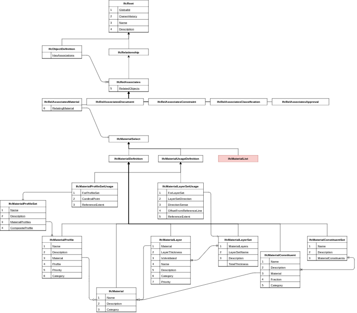

IFC materials
IFC can store information about real life materials, and objects can be assigned to materials. Materials may contain attributes like a name and description, and contain physical properties. Some of these properties are part of the IFC standard, such as concrete strength, thermal properties, or mechanical properties, or it may be a custom property defined by the user.
A material may be assigned directly to an object. However, for more complex materials, it is possible to combine multiple materials into a composite material. This composite material is known as a material “set” in IFC, and may then be assigned to an object. There are three distinct types of composite material sets.
  • Material layer set (each material within this represents a single layer)
  • Material constituent set (each material within this represents a single constituent)
  • Material profile set (each material within this represents a single profile)
When a material set is defined, it is sometimes necessary to describe which parts of the geometry a portions of the material set applies to. For example, when an object has a material layer set, we need to describe the thickness of each material layer. When we describe a material set assignment parametrically, this is known as a material set usage. There are two types of parametric usages that can be defined in IFC:
  • Material layer set usage
  • Material profile set usage
A material may also have a visual style associated with it, such as a colour. When viewing an IFC model, the colour of an object may represent its material.
However, it is also possible for IFC objects to be assigned a visual style or colour that is not associated with a material. This is a common cause for confusion, as users may think a colour represents a material. It is made more confusing by the fact that a visual style may have a name. This name is not the same as a material name, but some BIM software may not make the distinction between them.
A visual style may be used to represent non-material information. One common usecase is when a style correlates with a discipline. For example, all hydraulic objects may be coloured blue, and all mechanical objects may be coloured green. The concept of visual styles is a separate concept to materials, and will not be described further here.

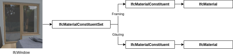

There are two typical usages of a material constituent set. The first typical usage is where a material is made up of a mixture of constituents, like how concrete is made up of sand, cement, aggregate, etc. Each constituent is mixed together, but represents a “fraction” of the whole material constituent set.
The second typical usage is where a single object is simply made up of different materials in an arbitrary structure. For example, a single window element can be made up of an aluminium frame and a glazed panel. In this case, geometry may be modeled that represents the frame, which is assigned to one constituent, and more geometry may be modeled to represent the panel, which is assigned to another constituent.
Although in this example geometry is modeled for each constituent, this is optional. It is acceptable to have a constituent set without needing to explicitly model each constituent geometrically.

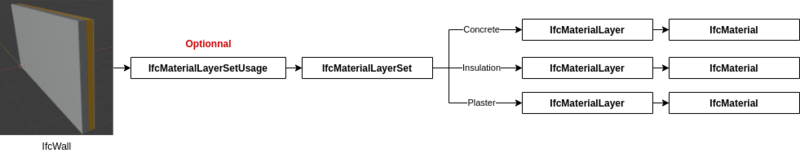

Assignment example
Following diagram shows how materials are related to their object. Any child of IfcObjectDefinition as IfcWall, IfcDuct etc… can get a material assigned this way :
