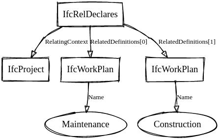

Work plans group work schedules, typically to distinguish between schedules for construction management purposes and schedules used for facility management purposes.
Note: the purpose attribute seems to have some similarities, but since it is so loosely defined, we don’t really know what to make of it. Also note that the docs for IfcWorkPlan seem to suggest that a work plan being declared to the project actually means that a work plan is about constructing the project. With some imaginative interpretation, this could mean that a work plan could be assigned to something else entirely, not with a declares, but instead with a IfcRelAssignsToControl relationship, and therefore only indirectly be assigned to the IfcProject. However, no evidence is found of a usecase of this.
Source: IfcWorkPlan, IfcWorkControl

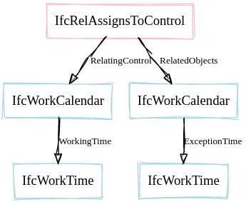

A project may have work calendars
A work calendar is a definition of working time and holiday times. Later on, this calendar can be used to describe when things are available or when tasks are allowed to take place. A typical calendar might be a 5-day working week, when you work on Monday to Friday and take Saturday and Sunday off.
Note: we are unsure whether or not it is more appropriate to store calendars at the project level or at the work plan level (described in another concept with caveats of its own) or both. For now, our implementation stores calendars at the project level.
Source: IfcWorkSchedule

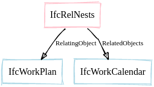

A work plan contains calendars
A calendar within a work plan implies that the calendar is related to the work plan, and may be used later on to describe availability for other concepts within the work plan, such as tasks or resources.
Note: there is only a single sentence describing this relationship in the source, and it uses a nests relationship which is different from all other work plan relationships, so we are suspicious about this concept and do not currently support it.
Source: IfcConstructionResource

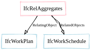

A work plan contains schedules
A work schedule is used to group together tasks to achieve a goal. That goal is related to the work plan that it is part of. Typically, a work plan will contain multiple schedules. Each schedule may be planned, actual, or a baseline.
Source: IfcWorkPlan

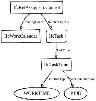

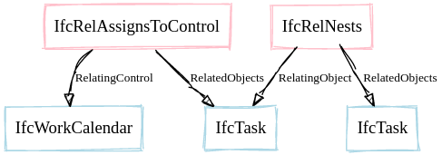

A work calendar determines when a task can occur
If a task is assigned a calendar, its duration may be specified in terms of working days (which IFC calls work time), instead of calendar / elapsed days. In this example, if the calendar is a 5 day working week, the task takes 10 working days, which is equivalent to 2 weeks of actual elapsed time.
Source: IfcWorkCalendar, IfcWorkSchedule

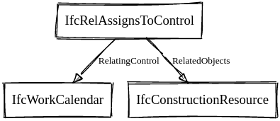

A work calendar describes when a resource is available
A resource is only available on certain dates and not others.

A calendar may override the availability of an inherited calendar
A calendar may be a child of a parent calendar. The exception times of the child calendar will first inherit, and then override the availability of its parent calendar. A calendar is only allowed to have one parent calendar.
It is currently ambiguous as to how the working times of a child calendar interacts with its parent calendar. We currently assume that if a working time is present in a child calendar, it also overrides the availability of its parent calendar.
For example: a parent calendar has a working time of Monday to Friday. The child calendar has a working time of Saturday, and an exception time of Monday. The final availability of the child calendar is therefore Tuesday to Saturday.

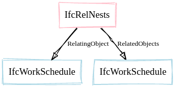

A work schedule may nest other work schedules
Uh. A schedule has subschedules. This is possible, but we have no idea what the usecase is. Nor we do know what it implies for derived dates, calendar inheritance, or cost derivation. We don’t currently support this relationship.
Note: there is also an ambiguous note about how work schedules can include other work schedules as sub-items using aggregation instead of nesting. We take a prudent stance that this sentence is just misleading and should be ignored.

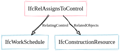

A work schedule may contain resources
A work schedule may define the resources that it uses.
Note: this concept is not fully understood, and why it is important to link resources to a work schedule as opposed to simply the tasks within it, or to a work plan.
Source: IfcWorkSchedule, IfcConstructionResource

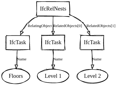

A task may contain subtasks
In construction scheduling, a task may contain subtasks. This hierarchy of tasks forms the Work Breakdown Structure (WBS).

A task may be assigned a task time, to determine duration and scheduling times
A task may have its duration described most simply in terms of elapsed time. In this case, the task takes 7 days.
Source: IfcTaskTime

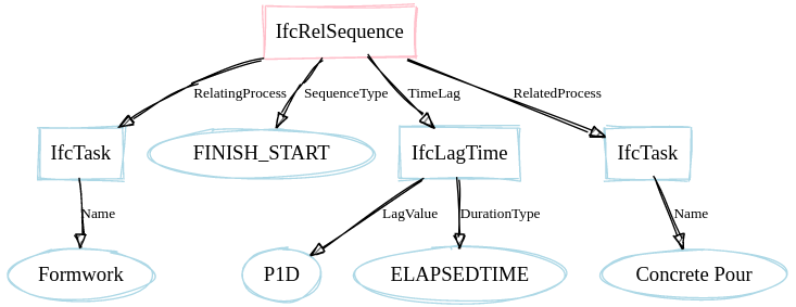

A task may have sequential relationships to other tasks
In this scenario, a predecessor task (setting up formwork) has a finish to start relationship to a successor task (pouring concrete) with a lag time of 1 elapsed day between them.
Note: When lag times are expressed as absolute duration in working days (i.e. not elapsed days), there is an ambiguity as to whether the predecessor or successor task calendar should be applied. Based off testing in existing scheduling software, it seems as though both calendars are applied, and the one resulting in the worse value (i.e. the longest lag time) is chosen.

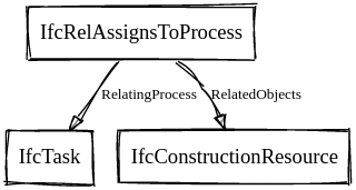

Tasks may consume resources
A task consumes resources.
Source: IfcTask, IfcProcess, IfcConstructionResource

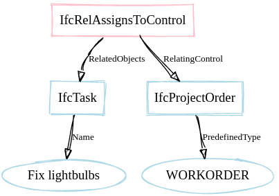

A task request may result in a project order being created
A request of work, maintenance, purchasing, or other types of requests may be represented as an IfcTask typically to a helpdesk or building maintenance company. This may then result in a project order being created.
Note: the wording behind this concept is ambiguous in the documentation, and the usecase of a helpdesk is not fully elaborated. Therefore this description should be treated with suspicion.
Source: IfcTask

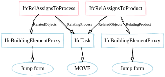

A task may move a product from one location to another
A task may involve moving products from one location to another. A typical example would be a jump form moving between floors of a building. The product is duplicated at each possible location that it may be at different points of time.
Source: IfcTask

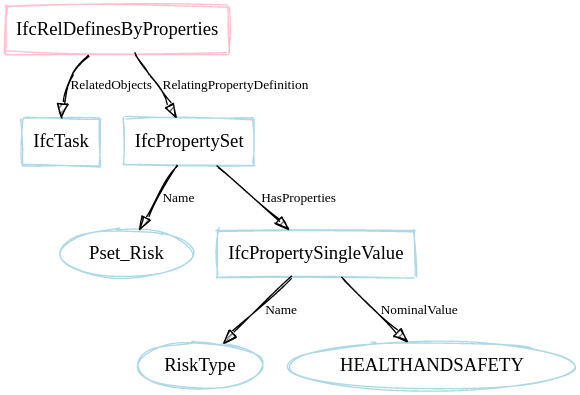

A task, event, or procedure may contain properties
A task, event, or procedure may contain properties. Typically this is used for risk assessment. For logistic tasks, it may also contain properties for packing instructions.
Source: IfcTask

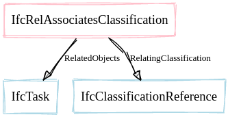

A task may be assigned a classification reference
If tasks are based on an external classification system, such Omniclass, which guides the hierarchy of the work breakdown structure, the task may be assigned to a classification reference.
Source: IfcTask

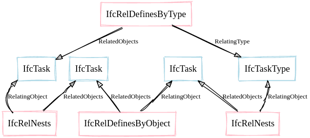

A project task may be based off a typical task type or template from a library of tasks
Whereas an IfcTask represents an actual task within a project’s work schedule, it may be derived from a task template, also called a task type. Task types are not project specific and may typically be shared within a library of tasks to aid planners in creating schedules.
Source: IfcTask, IfcTaskType

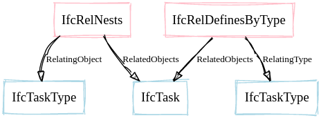

A task type can nest a task type
Note: It is currently ambiguous as to what this means.
Source: IfcTaskType
Source: IfcTaskType
A task type can nest a task, that is also typed
Note: it is currently ambiguous as to what this means.
Source: IfcTaskType, IfcRelDefinesByObject
When a task type is used in a project, its child tasks are linked to the project tasks
When a task type with subtasks is used in a project, it creates corresponding task instances in your task tree. To correlate these task instances back to the task type, an object relationship is created.
Note: usecases and workflows of this is still currently ambiguous. Also, there is a discrepancy where the documentation in IfcTaskType describes a nesting relationship, whereas the IfcRelDefinesByObject documentation describes an aggregation relationship.
