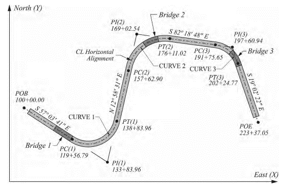

The concepts this post focuses on are horizontal alignment and vertical alignment (sometimes referred to as vertical profile). Railway cant and roadway superelevation are not discussed. The alignment provided in the FHWA Bridge Geometry Manual will serve as an example. The horizontal and vertical alignments are shown in Figure 1 and Figure 2, respectively.
Figure 1: Horizontal Alignment. Source: FHWA
A horizontal alignment typically consists of straight lines called tangents that are connect by curves. The curves are usually circular arcs. Easement or transition curves in the form of spirals can be used to provide gradual transitions between tangents and circular curves. There are many types of transition curves utilized in practice, with the most common being the clothoid or Euler spiral.
The horizontal alignment is a plan view curvilinear path in a Cartesian coordinate system aligned with East and North. Positions along an alignment, measured along the plan view projection of the 3D curve alignment curve, are denoted with stations or chainage. The example alignment has four tangent runs connected by three horizontal curves. The alignment begins at Station 100+00 and each station is equal to 100 feet in distance along the alignment. The first curve begins at Station 119+56.79 which is 1,956.79 feet, or 19.5679 stations, from the alignment’s point of beginning.

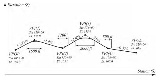

A vertical alignment consists of straight sections of grade lines connected by vertical curves. The vertical curves are typically parabolas or circular arcs, though clothoids or other transition curves are occasionally used. A vertical alignment is defined along the curvilinear path of a horizontal alignment in a Distance Along, Elevation coordinate system. Combined, the horizontal and vertical alignments define a 3D curve. This combination of two 2D curves is sometimes referred to as a 2.5D geometry because the vertical alignment must be projected onto the corresponding distance along the horizontal alignment in order to determine the Z coordinate at any given point of interest.
The example vertical alignment consists of five gradients connected by four parabolic vertical curves.

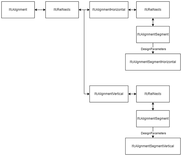

The IfcAlignment semantic definition is composed of an instance of IfcAlignmentHorizontal and IfcAlignmentVertical through an IfcRelNests relationship. The IfcAlignmentHorizontal and IfcAlignmentVertical are in turn composed of one or more IfcAlignmentSegment entities through IfcRelNests relationships. The IfcAlignmentSegment models the segment design parameters in a subtype of IfcAlignmentParameterSegment; IfcAlignmentHorizontalSegment and IfcAlignmentVerticalSegment in this case. The semantic definition model is shown in Figure 3.
An interesting caveat of IfcAlignmentHorizontal and IfcAlignmentVertical (and IfcAlignmentCant) is that the last IfcAlignmentSegment.DesignParameters must be zero length. If a geometric representation is provided, then its corresponding last segment must also be zero length. For a continuous composition of segments, the end of one segment is at the same location as the start of the next segment. The zero-length segment is intended to provide the end point of the last segment.

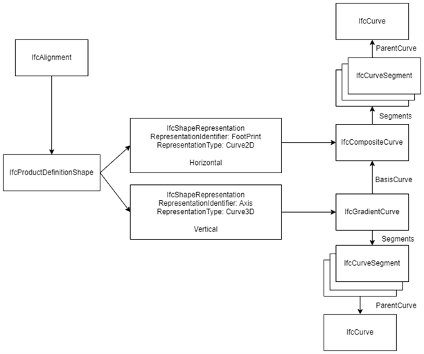

The geometric representation of the IfcAlignment consists of an IfcShapeRepresentation for the plan view horizontal alignment as well as a 3D curve for the combined horizontal and vertical alignment. This is illustrated in Figure 4.
Geometrically, the horizontal alignment is defined by an IfcCompositeCurve and the vertical alignment is defined by an IfcGradientCurve. The horizontal alignment is the basis curve for the vertical alignment.

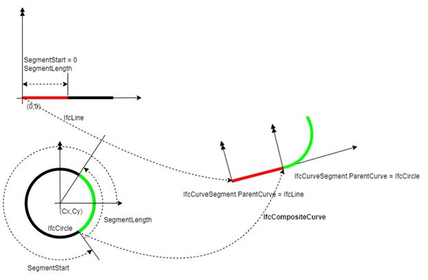

The geometric elements are modeled with IfcCurveSegment. IfcCurveSegment cuts a segment from a parent curve and places it in the alignment coordinate system. A horizontal circular arc is modeled with an IfcCurveSegment that cuts an arc from an IfcCircle. Figure 5 shows an alignment consisting of a tangent run (red) and a horizontal curve (green). The line and curve segments are cut from their IfcLine and IfcCircle parent curves, respectively. The process of defining a parent curve, cutting a segment from that curve, and placing the cut segment into the alignment is repeated to define the entire horizontal and vertical alignments.
All the horizontal alignment IfcCurveSegment objects are then combined to create an IfcCompositeCurve to complete the plan view geometric representation of the horizontal alignment.
A similar process is used to create the vertical alignment. Parent curves are defined and IfcCurveSegment segments are defined that cut a portion of the parent curve and position it in the XY plane where X is distance along the horizontal alignment and Y is elevation. The vertical alignment IfcCurveSegment objects are then used to create an IfcGradientCurve. The IfcGradientCurve uses the horizontal alignment IfcCompositeCurve as its basis curve, which means the horizontal coordinates of the vertical alignment are taken from the horizontal alignment curve as illustrated in Figures 1 and 2.
Figure 5: Illustration of parent curves and their placement with <code>IfcCurveSegment.Placement</code>
When defining an IfcCurveSegment, the location and orientation of the parent curve are not particularly important. The Placement attribute of IfcCurveSegment defines the location of the start point of the trimmed curve as well as the orientation of the tangent at the start of the trimmed curve.

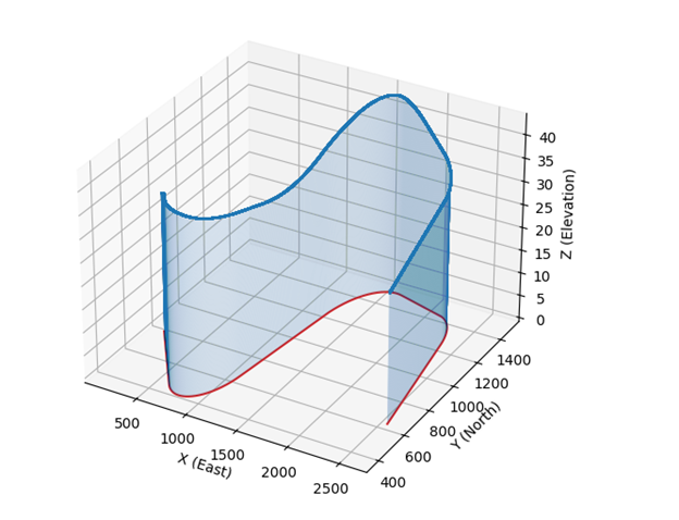

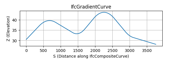

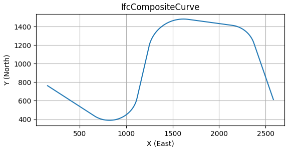

The output of the example programs is a file called FHWA_Bridge_Geometry_Alignment_Example.ifc. The geometry created by IfcOpenShell is shown in the following figures: Figure 6 is the alignment plan view, Figure 7 is the vertical profile view, and Figure 8 is a 3D representation of the alignment.
Figure 6: Alignment Plan View
Figure 7: Alignment Profile View
Figure 8: 3D representation of the alignment

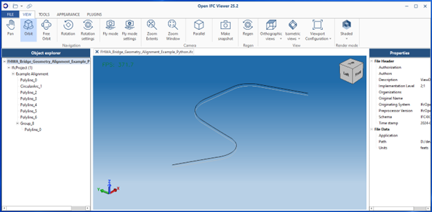

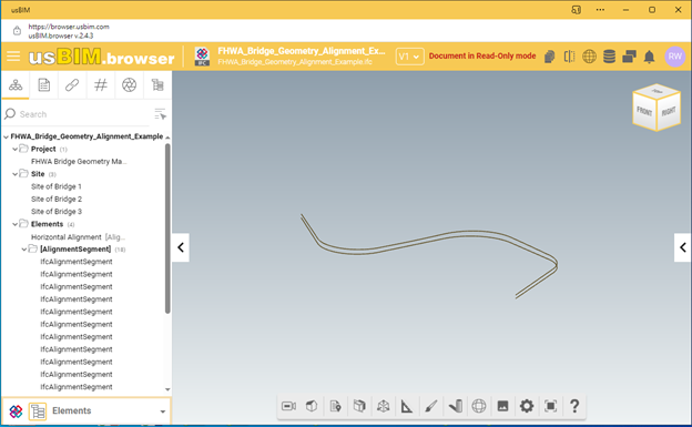

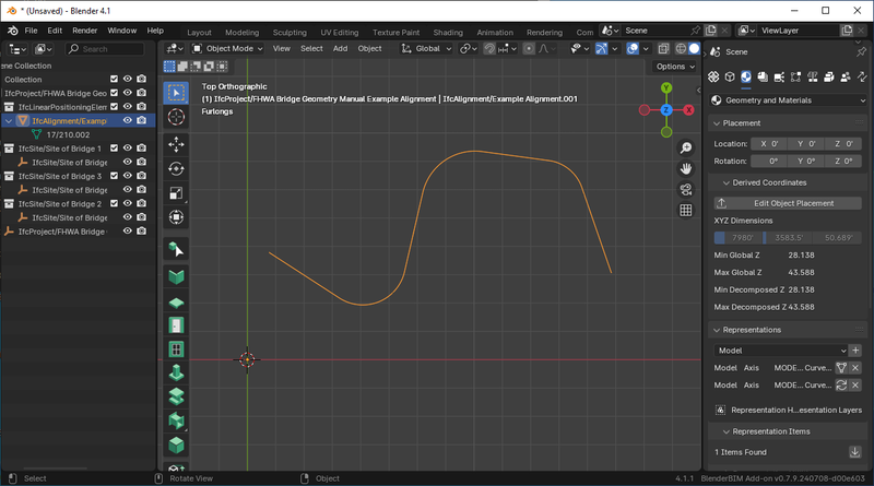

The generated IFC file may be viewed in any IFC viewer that supports IFC 4.3.2. Figures 9 through 11 show the alignment in viewers from ODA, ACCA, and Blender.
Figure 9: Alignment shown in ODA Open IFC Viewer 25.2

Figure 10: Alignment shown in ACCA usBIM v2.4.3
Figure 11: Alignment shown in Blender
