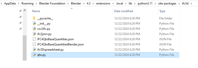

There are the three files that are interesting:

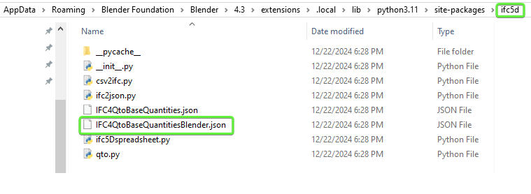

  1. ifc5d folder > *.json file
patht to file

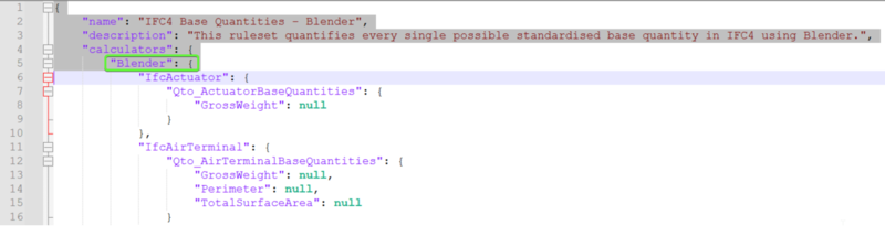

In this folder there are the .json files that map all the classes and properties with the calculating functions. So for example let’s open “IFC4QtoBaseQuantitiesBlender.json”:
The first four lines contain infos about the ruleset (Name, Description) and the type of the “calculator” (Blender in this case).
json file
The other lines map the object property standard class with the blender calculating function. If there is a Null instead of the calculating function name, it means that there is no mapping and the calculation is not performed.

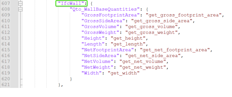

For example, “IfcActuator”: {Qto_ActuatorBaseQuantities": {“GrossWeight”: null}} will not perform but “IfcWall”: {“Qto_WallBaseQuantities”: {“GrossVolume”: “get_gross_volume”}} will.
IfcWall calculation
In this case, this means that, for every IfcWall object, there will be created a new Quantity Set called “Qto_WallBaseQuantities”, with the “GrossVolume” property and the function “get_gross_volume” will be used to calculate the (gross) volume.

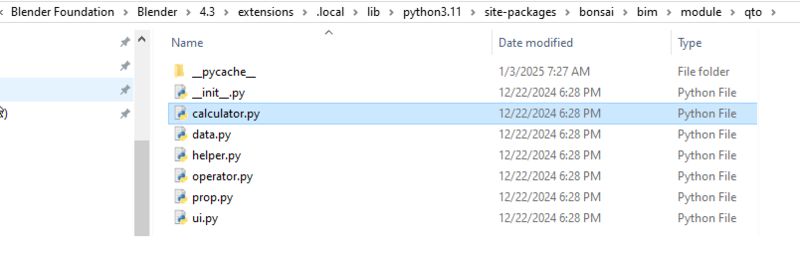

So, where are these functions? Because this ruleset uses the Blender calculator, the calculating functions are stored here:
  1. /bonsai/bim/module/qto/calculator.py
calculator py

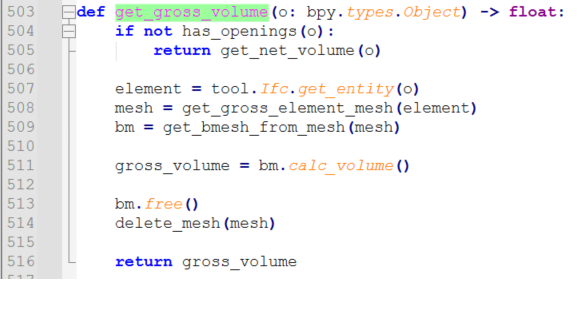

This file contains the calculating functions so, for example, if you open it you will find the “get_gross_volume” function and you can see what the function actually does in order to perform the calculation:
get_gross_volume_function

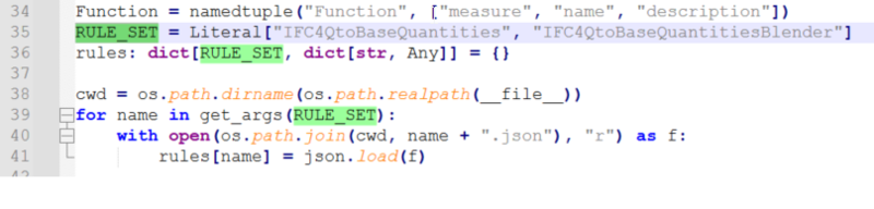

In this file there is the RULE_SET variable definition that is a list of all the available rulesets. It needs to correspond with the .json file name located in the folder.
rule_set function
This file also contains the correct definition of the calculating function so, if we add new calculating functions, it is necessary to also add new lines there.

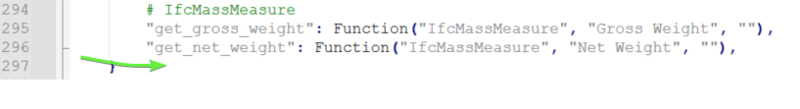

7. Define the new functions in the “/ifc5d/qto.py” file in order to correctly add the new calculating function by adding the following lines under #IfcMassMeasure section under Blender class
add new functions
# Rebar
"get_rebar_beam_weight": Function("IfcMassMeasure", "Beam Rebar Weight", ""),
"get_rebar_slab_weight": Function("IfcMassMeasure", "Slab Rebar Weight", ""),
Et voilà, now it should be possible to perform the Quantity Take-off method with a custom defined ruleset.
