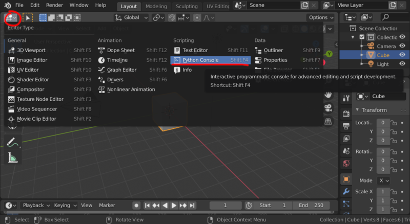

How to switch to Blender Python console mode
Running IfcOpenShell commands in the Blender console

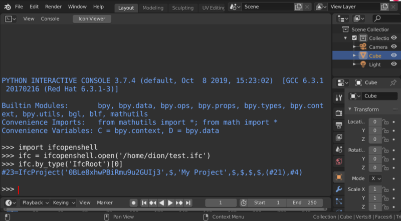

You can launch an interactive Python shell letting you query BIM data in real-time. To do so:
  1. Install Bonsai and ensure it is enabled
  2. Switch to the Blender Python console mode.
  3. There is no step 3.
You can now type in import ifcopenshell and it’ll work! Have fun!

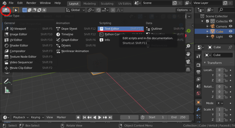

How to switch to Blender's built in text editor
Alternatively, you can write a full script from a text file and run it. Instead of switching to the Python console mode, just switch to the Blender text editor mode, and press the Run Script button in the top right once you’ve written or loaded a script. You can also press Alt P as a short cut, but your mouse cursor must be over your code when you press the hotkey.
The Blender text editor has basic line numbers, syntax highlighting, and line wrapping abilities. The output will be to the system console (not to mistake with Blender Python Console). On Mac and Windows, the console may not be visible. To make it visible on Windows, go click on Window > Toggle System Console. On Mac you need to start Blender from terminal with "/Applications/Blender.app/Contents/MacOS/Blender" -con (path can be different depending on your Blender installation).
