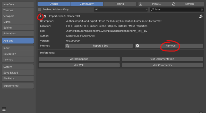

Uninstallation
Find Bonsai entry in the Edit > Preferences > Add-ons window, and press the Remove button.
