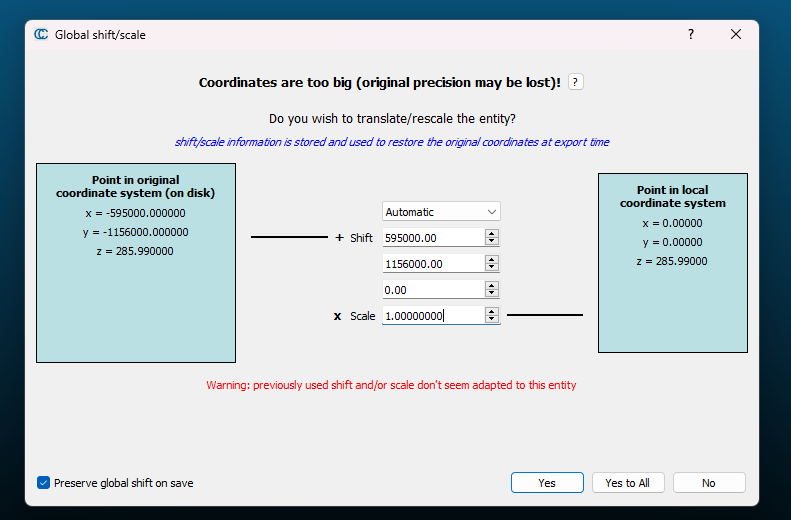

BlenderGIS can only import dxf or shp. Czech server provides land registry map as .shp, so that’s solved. The DMR 5G laser scan is provided as .las point cloud so we’ll use Cloudcompare to move it to YPCS and convert it to a mesh:
  1. start Cloudcompare and open the las file. When asked to transform the coordinates input your project origin (0,0 of YPCS in CRS with -) as a shift: CloudCompare coordinate shift for Bonsai site data
