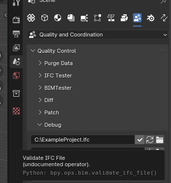

IFC file validation is available from Quality and Coordination tab -> Debug section (check the screenshot).
You can either open project in Bonsai or just select it only for debug.
After validation is finished (it can take some time on large projects) you’ll be able to check the results in Blender System Console.
On Windows and Unix it can be opened in Blender from Window -> Toggle System Console.
On Mac to see the system console Blender should be started from the terminal with -con argument:
"/Applications/Blender.app/Contents/MacOS/Blender" -con.

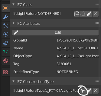

To find those of the type “Beton”, go to an object of a type you want to select, then in the object properties this button will select all of that type:

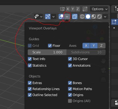

  • A quick way to check quality of geometry is looking at Statistics. Statistics are enabled from the ‘Viewport Overlays menu’. Stats will show in top left part of screen.
