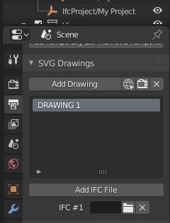

A view is basically an orthographic camera, which you can place manually, or by using the “Add Drawing” button in Output Properties > SVG Drawings. This command creates the necessary camera with a default name, centered on origin. The newly created camera is automatically activated and you can rename it by double clicking its name.
You can also activate any camera used as a view by selecting it from the list and using the “Activate View” command.

The ifc file on which the vector cut will be performed has to be chosen under Output Properties > SVG Drawings > Add IFC File and selecting one or more IFC files.
Selecting an IFC file for a section cut

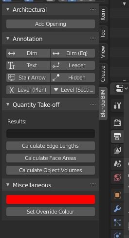

The plug-in provides commands to create the correctly named dummy object in the Sidebar (“N” panel) > Bonsai > Annotation.
Dummy annotation objects

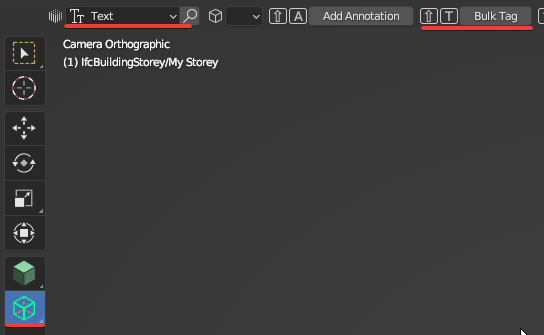

Intelligent Tagging of Objects
Go here for adding labels, like wall/window tags, that are intelligently linked to the object’s data.
To tag objects:
  • select Annotation Tool choose annotation type
  • select objects to tag
  • use “Bulk Tag”
If you moved the tagged objects or changed them (for example stair is wider now) you can readjust tags by selection annotations and using “Readjust” in Annotation Tool.
Currently there are 2 ways of tagging:
  1. Text tagging - will create IfcAnnotation of type Text at the center of the object then you can refer to the tagged object properties in the text. More.
  2. Stair Arrow tagging - will create stair arrow by the stair X axis going until the last stair step. Example.

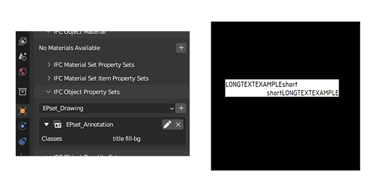

Text Styling
  • Background for Ifc Text annotations in SVG To add fill background of Ifc Text annotation with white color you can add “fill-bg” class to EPset_Annotation.
    Top: in Blender setup, Bottom: the result in svg

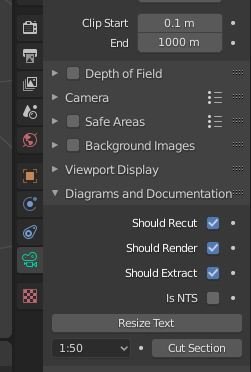

Exporting a view
To export a view, select the proper camera, go to Object Data Properties > Diagrams and Documentation > Cut section. On running the “Cut section” command a SVG file is generated in the Diagrams folder in your Data Directory. The contents of the generated SVG file depend on the options you check in the Diagrams and Documentation section:
  • Should Recut - a vector image is generated by intersecting a plane parallel to the camera plane in camera origin with geometry of the ifc files selected in Output Properties > Documentation.
  • Should Render - a raster image is generated by rendering the current Blender model with the current camera
  • Should Extract - metadata from the IFC file, such as material or property data (such as in smart annotations), are re-extracted
