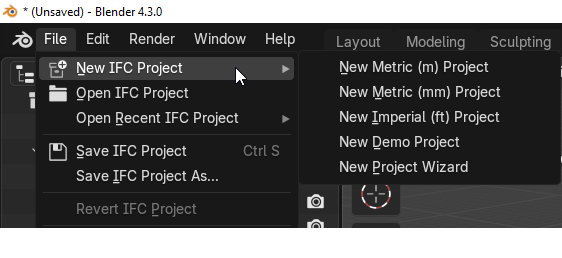

  1. You can find the command in Blender-Bonsai under File –> New IFC Project and Choose which unit, template, or from the wizard panel
  2. Make sure to use IFC4 or IFC4x3, otherwise convert your IFC2x3 file to IFC4 or IFC4x3

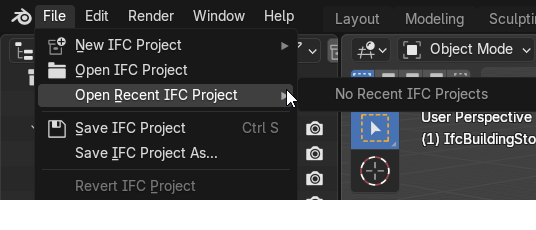

  • Option 2: Open an existing .ifc file
Open an Existing IFC Project
  1. Go to File –> Open IFC Project
  2. Navigate to your .ifc file and click Load Project or
  3. Open Recent IFC Project from the drop-down menu

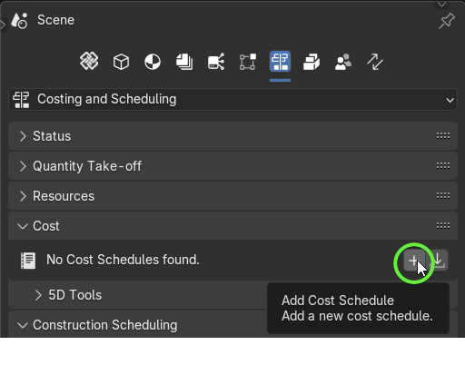

Cost Schedules can be added under the Blender Scene Properties > Cost and Scheduling > Cost Panel.
Clicking “+ Add Cost Schedule” will add as many schedules as required.
Create a New IfcCostSchedule

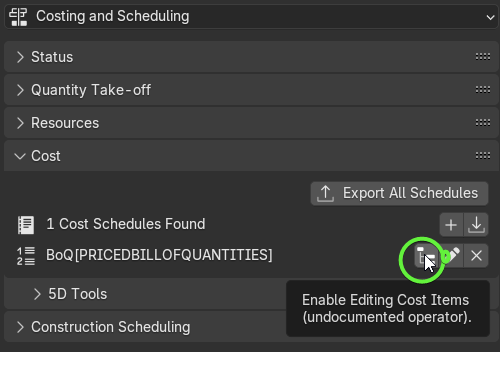

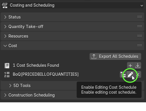

Click on the Folder Tree to Enable Editing Cost Items
Open a Cost Schedule for Editing

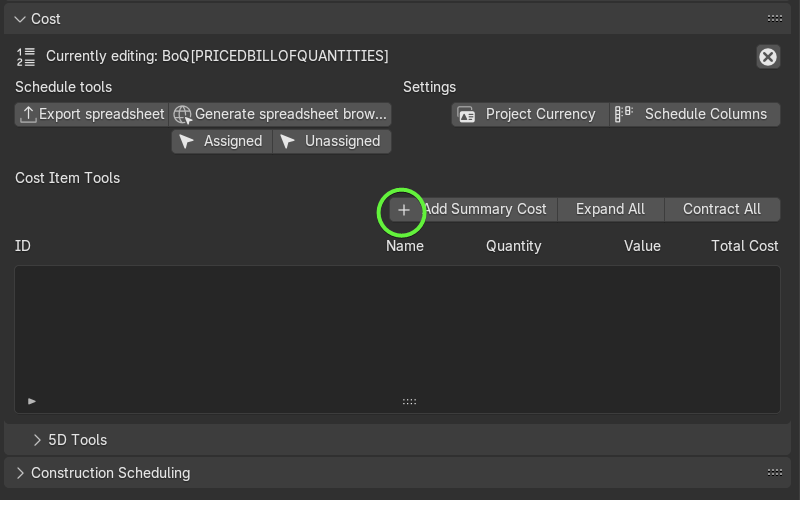

To add a Cost Item click on “+ Add Summary Cost”
Add Summary Cost
Add Summary Cost

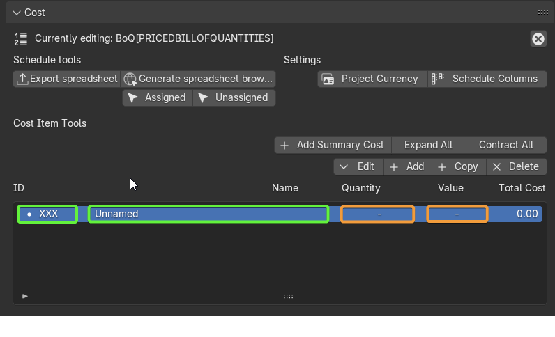

Attributes are editable directly from the panel (in the green frame) by double-clicking on them
  • ID : the Identification value of the Cost Item, typically according to a Cost Breakdown Structure (CBS) or similar
  • Name : the name assigned to the Cost Item or a short description of its scope

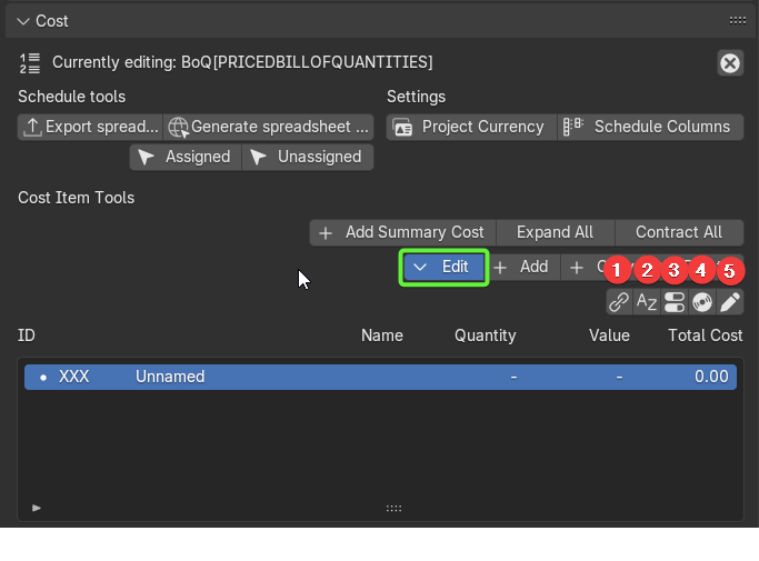

Other attributes can be edited by selecting the “Edit” icon and clicking on the “pencil” as indicated below
Cost Item Edit Menu
Cost Item Edit Menu
Items editable activating the Edit icon:
  1. Cost Item parenting hierarchy
  2. Sorting order
  3. Quantity
  4. Value
  5. Edit attributes

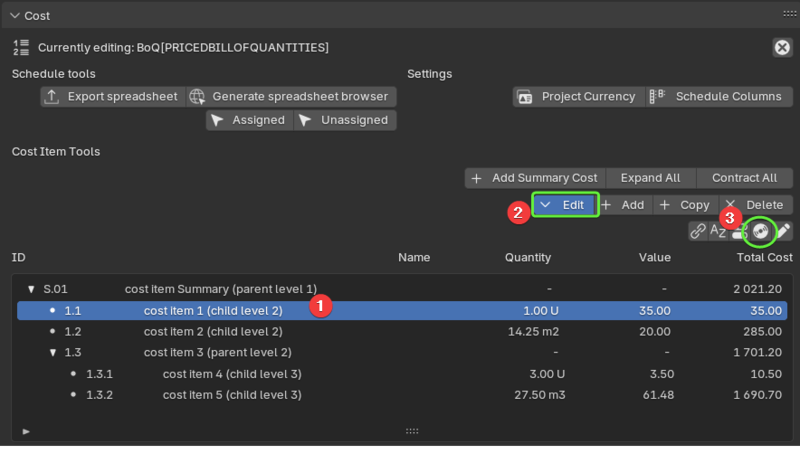

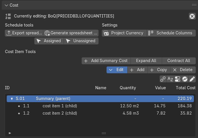

The parent items, or Summary Cost Items, should contain calculations of overall quantities and/or overall costs, whilst the related nested items would contain the specific quantites and costs of assigned Building Elements, Processes, or Resources.
In the image below parent Item S.01 contains the SUM of the child items 1.1 and 1.2 below
Cost Item Hierarchy
Cost Item Hierarchy

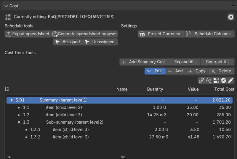

Cost items can be further nested like in the image below where the top item contains cost items 1.1 and 1.2, and a summary cost item 1.3 which itself contains cost items 1.3.1, and 1.3.2
Cost Items Nested Structure

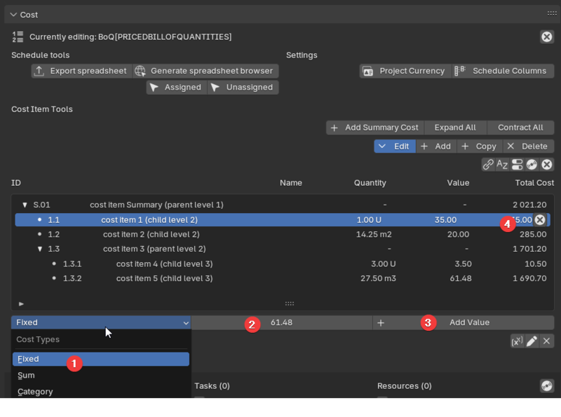

Add Cost Item Values
  1. Manually To manually add a value to a cost item, select the item, then “Edit”, and click on the “disc” icon
edit cost item
now some options become available at the bottom of the panel
in this example (1) select “Fixed” from the drop-down menu, (2) enter the desired value, (3) click on “Add Value”, and (4) close the cost item edit
Edit cost value
The cost item has a value that is multiplied times the “quantity” to calculate its “Total Cost”

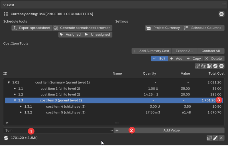

If the cost item represents a “Summary”, or a parent of nested child cost items, the procedure is as follows: (1) Select “Sum” from the drop-down menu, (2) click on “Add Value”, (3) close the cost item edit:
add a sum value to a cost item

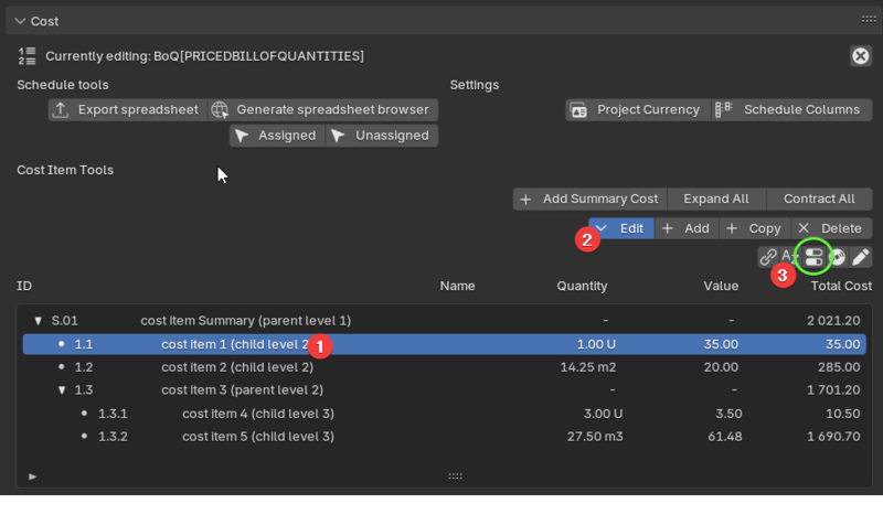

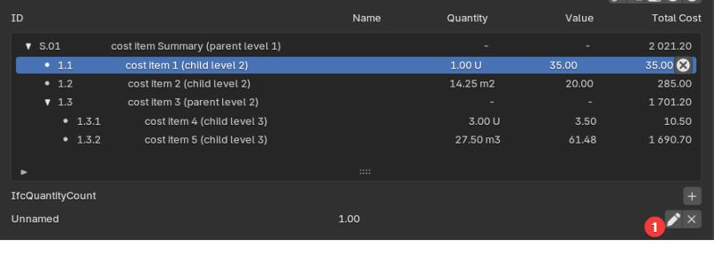

  1. by manually enter it: (1) select the Cost Item, (2) “Edit”, (3) click on the “switch” icon
edit quantity
then click on the “pencil” to edit it

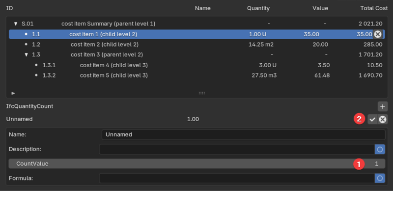

quantity edit 2
Once the panel below is available (1) enter the quantity in the box (in this case it shows CountValue, if a different unit is used, like volume or area, it may not look the same), (2) click on the tick icon to close it
edit quantity step 3
