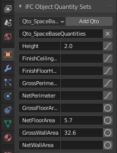

Adding IFC quantities
Quantities are linked to the IfcElement Class. There are predefined Quantity Take Off sets which add a batch of Quantities.
A QTO set can be added by selecting an object, going to Object properties >IFC Object Quantity sets and picking a predefined Quantity set. A new batch of lines with the Quantitie is then added and the values can be filled in.
Bonsai provides also a guessing feature to fill the quantities automatically. By clicking the button next to the quantity field, the quantity will be calculated and filled in. However, this feature has its obvious limits: the quantity in question has to be clearly defined by the geometry.
Object IFC quantities UI
